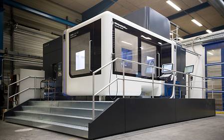

The robust rotary table of the DMU 210 FD can accommodate parts up to 1.850 mm in diameter and 5.000 kg.

The machine has a portal design for the highest precision and dynamics up to 3m/s2.

With 44 kW power and 10.000 RPM on the main spindle, the machine is well equipped to cut even the hardest exotic materials.

DMU 210 FD 5-axis universal machining center with integrated grinding functions.
