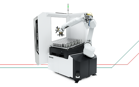

Robo2Go
Robo2Go by DMG MORI
  • Dialogue programming via CELOS, no robot programming knowledges necessary
  • Fast creation of a process with predefined program modules
  • Multijob function: Process various jobs with one tray
  • Stacking of workpieces
  • Handling of shaft parts
  • Parallel gripper, outer and inner gripper
  • Parallel use with bar loader possible
  • High acceptance by modern working environment - Fenceless system with ergonomic access to the machine
  • Flexible setup at multiple turning machines
